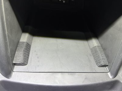

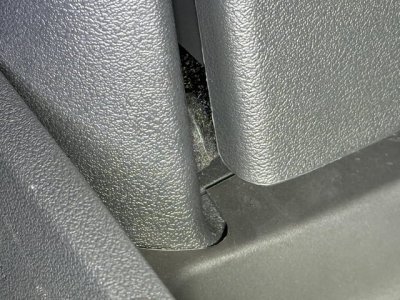

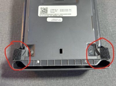

Step one: Grab some Velcro strips—any kind will work. Attach them to the places I marked in my pictures (two on the drawer, two inside the vehicle).

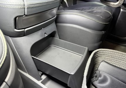

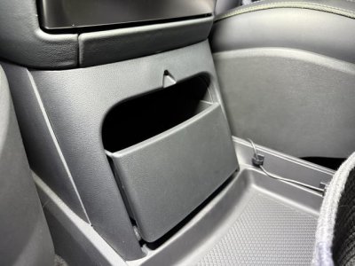

Step two: Slide the drawer in. You’ll need to push a bit firmly to get it to snap into place. Check the vehicle’s display to make sure it’s locked and the system detects the drawer (Gen1 vehicles will pick it up).
Step three: Double-check that the Velcro is sticking tightly. At this point, you’ve got a working storage drawer in your Gen1! But I found an extra trick to make it feel super sturdy, which I’ll share next.
Step four (optional): Pick up some furniture felt pads, or any felt material will do, though the furniture ones are best. Stick two pads together (you’ll need four total). Pull the drawer out a bit for easier access. Then, wedge the felt pads between the drawer’s plastic edge (where the Velcro is) and the vehicle’s trim. Make sure they’re snug on both sides. This keeps the drawer rock-solid with no wobble at all.
