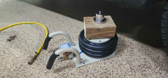

I recently tried a 3-ton, triple-bag air jack from Amazon for rotating my Rivian’s tires, and I wanted to share my experience for others on the forum. It cost less than $100 on a Prime deal and is small enough to store easily.

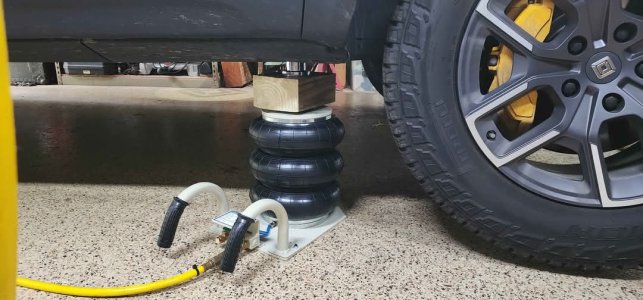

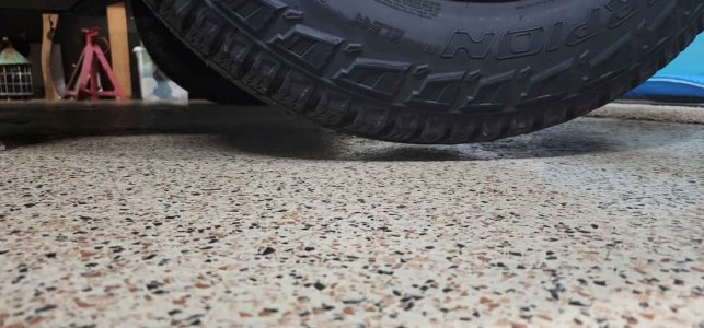

I already have a 3½-ton floor jack, but you don’t need to lift the truck’s full 7,000 pounds. With a 4x6 wood block, 90 PSI air pressure, and the Rivian in tire change mode, the jack worked great. The process was straightforward, and I’m happy with how smoothly the tire rotation went.
I’m really pleased with this air jack and thought it might help others looking to rotate tires at home. It’s compact, so it doesn’t clutter my garage, and it lifted the truck easily with the wood block and proper air pressure.
The tire change mode kept everything steady, making the job quick and simple. If you want an affordable, reliable way to handle tire maintenance without heavy equipment, this setup is worth trying.
