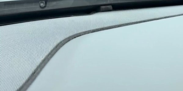

My fix was super simple. I rolled up some black felt and tucked it between the windshield and the back of the speaker grill—it blends in nicely and doesn’t stand out.
Then, I placed a strip of felt along the front of the grill, right where it meets the leather dash. This completely stopped the rattling for me. It’s an easy DIY trick that works great, and I hope it helps other owners quiet their Rivian's too.
